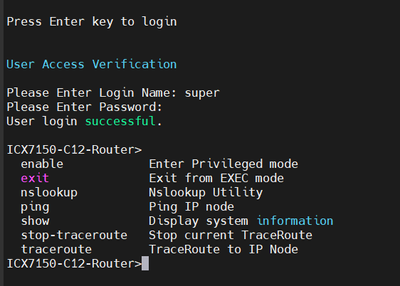

BT
Hi Imran,
Thank you for your guidance I have been able to successfully login with a combination of username and password from the screenshot. I have also reset the password when prompted. What steps should I now perform?
