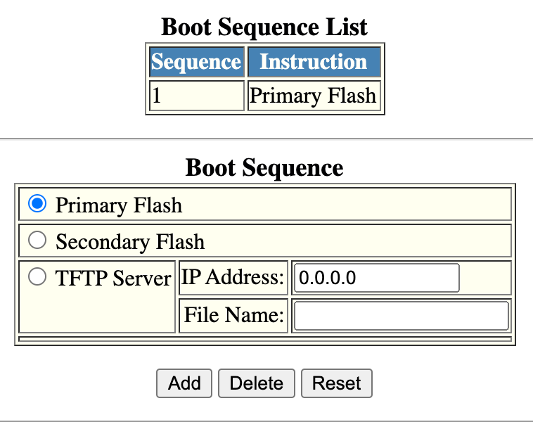

On the WEB GUI, I see the following. I wonder if my primary got corrupted somehow? Why is it T211 not T213 like the secondary? What's the next best step? Should I reset? Or upgrade the firmware?
Flash Primary Image Version: 08.0.90T211, size=28660224
Flash Secondary Image Version: 08.0.90T213, size=32539748

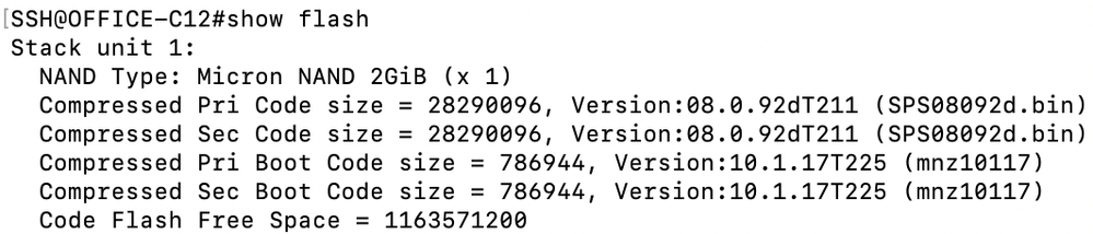

Can you get back into that switch, run the command "show flash" and paste the result? I'm not saying you need to upgrade to 92d or have the primary and secondary the same, I'm just curious right now. Also, you should be able to set the boot, save it, and then reboot immediately. The logout and login again aren't really required.

SSH@ICX7150-C12 Router>show flash
Stack unit 1:
  Compressed Pri Code size = 28660224, Version:08.0.90dT211 (SPS08090d.bin)
  Compressed Sec Code size = 32539748, Version:08.0.90dT213 (SPR08090d.bin)
  Compressed Pri Boot Code size = 786944, Version:10.1.15T225 (mnz10115)
  Compressed Sec Boot Code size = 786944, Version:10.1.15T225 (mnz10115)
  Code Flash Free Space = 1131024384
BTW, I think, but I'm not sure that I set the default boot correctly. But I did several times "boot system flash primary", but it keeps showing the secondary when I do "show version". This has been complicated, and the firmware upgrade looks even harder, so I would like to not do that if not needed.
    UNIT 1: compiled on Sep 23 2019 at 00:00:25 labeled as SPR08090d
      (32539748 bytes) from Secondary SPR08090d.bin (UFI)
        SW: Version 08.0.90dT213
Image_ images_messages_60a2e1e38c74ef317253862a_71dfc15ebed6b0377c9fafd81ba83917_ScreenShot20210517at5.35.57PM-8f7c9ae3-1bc5-466a-aa34-50b2b4ab7bbb-918916724.png
SSH@ICX7150-C12 Router>enable
SSH@ICX7150-C12 Router#show boot-preference
Boot system preference(Configured):
Boot system flash primary
Boot system preference(Default):
Boot system flash secondary
