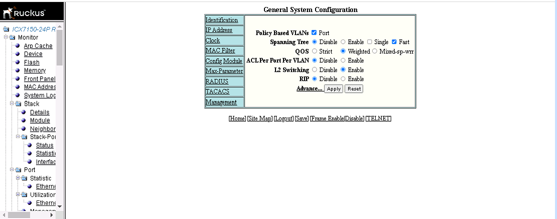

Hi @mjstich
Could you please use the Switch IP address and access it in the Web browser and try to log in there?
Please let me know if you can log in to the web dashboard.
