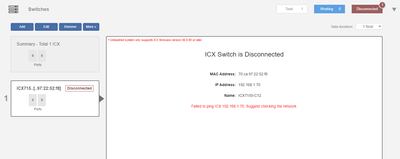

PST-ICX Switch is Disconnected after power outage
EduardoC
https://support.ruckuswireless.com/cases/01409741
This is the the same issue as in
https://community.ruckuswireless.com/t5/RUCKUS-Support-for-Lennar-Homes/Ruckus-switch-unreachable-di...
But I do not see a solution for that. I am not a network specialist so some suggestions are too technical for me

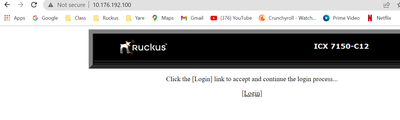

Hi @EduardoC
Ok, so if the Online web access is not working, you need to get access via console, using the next connection the USB will be connected on your computer and the type C on your ICX7150 Switch.
Note: the SSH and Telnet access will not work for you, because you are having connectivity issues to reach the IP address 192.168.1.170 and those are for remote access, however console is local, so will no matter if you have or not an IP address.

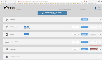

Hi @EduardoC
Are you an Unleashed Lennar Home client?
Yarenis Hernández
EduardoC
Yes we are
Hi @EduardoC
Just to clarified your issue, please response the next questions:
Is your Switch online, but from Unleashes is displayed as disconnected?
Is your unleashed network working fine?
Are all your Access Point online and working as expected?
Are you having connectivity issues in your Unleashed network?

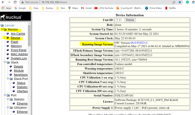

Can you gain accesses to the Switch IP address that may be displayed in the Unleashed dashboard, if that is the case, access and provide the next information from there?
While your computer or phone is connected to the Unleashed network, search the IP address of your Switch>open a browser and paste the Switch IP address Monitor>Device
Note: you can use the next guide to find the Switch IP address:
Yarenis Hernández
EduardoC
Is this what you are asking for?
