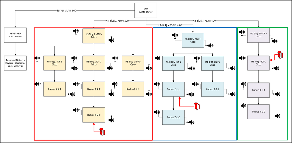

If the audio is live, it is coming from one of the end-point Push to talk IP based microphones. Those mics are initiating the multicast. The multicast is only going to the local switch ports and down stream when there is a downstream switch.
The vendor is Advanced Network Devices - https://www.anetd.com/products-categories/ip-displays/
Here is a stylized layout.
