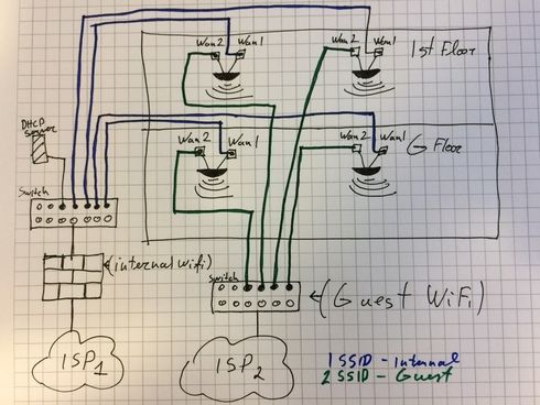

My company is expanding a bit and getting some extra access points like R710.
Main idea is that we have 2 ISP one used by guest wifi AP's and another one is internal network IP used bu other AP's. We are planning to get some extra AP's R710 and run guest & internal wifi on one AP. If that is possible?
Some more details:
Internal network will get IP from DHCP server
Guest network will get IP from AP DHCP server
Both networks is totally segregated
If that is configurable there is second challenge. On the guest wifi network we have some users using PPTP VPN and Ruckus AP in standalone mode can support only one client at the same time, if we would get a zonedirector 1200 would that be the able to help us and still keep existing configuration?
Many thanks,
